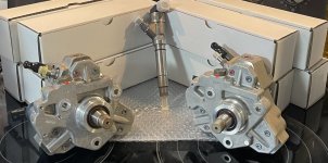

I ended up going to DDP for my entire high pressure fuel system on this truck. Flux, at this time, is unable to do LLY injectors in the size I required for this truck. Lenny and Skyler got this set knocked out in 4 days total from the time of me saying "I need a set" to "Hey, they shipped". We ended up at ~451mm3 average @ 1700us/180mpa. Lenny has told me this set can run up to ~220mpa reliably without issues but based on the flow sheet I won't ever need to run there but who knows, it may be a good way to gain some flow if we don't want to change duration.
Initially I had planned on running the new Industrial Injection 14mm stroke/9mm plunger XP pump but it is not available at this time and it appears that it will not be availible for quite some time yet so I've gone to 2x 12mm pumps but I am putting the second pump where the AC compressor typically would be to give myself the compromise of two pumps but no added pulleys. I will be making lines to where the valley CP3 will feed the passenger side rail and the belt driven pump will feed the driver side fuel rail. This should give me a much more even distribution of fuel and result in a much more even fuel pressure across the system VS forcing all the fuel for the passenger side injectors to come through the crossover line.
I'm running their injectors, two of their 12mm pumps, their 240mpa rail pressure sensor, and finally an S&S 240mpa single stage relief.

I want to see those things flowing some fuel through them on a test bench. I bet it looks like a fire hose...
BTW I received my Pump. (y)
One way to find out. They hit the fuel target nicely and are very responsive in the sub-2000us range which is EXACTLY what we were after. This is one subject I don't know much about so I leaned heavily on DDP's and my tuner's knowledge of the desired fuel quantity for my goals.
