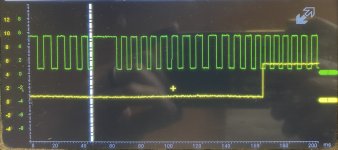

After making this post, I did a comparison to my 06 and can see the cam/crank signals aren't sync'ed up the same on the non running truck as they are on my truck. I'm assuming maybe the reluctor wheel on the LMM has moved out of position. Looks like I'll be pulling the front cover to figure out what is going on.

The scaling is off a little because one truck was running and the other was just cranking, but if you count the teeth on the crank from the gap to the step on the cam reluctor plate, you’ll see the problem. Now the question I have is why it wasn’t throwing a cam/crank correlation code.

you sure its just not a lag issue between the two from what a running truck has verse non running? if you disconnect the injectors on the running one, might give you a more comparable scan before you start tearing in more.
otherwise, i wonder if the truck had a backfire or something and the cam pin sheared when it stopped running the second time. so now its out a few degrees.

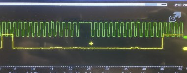

I’m 100% sure the cam and crank are not lined up properly. This is what the running truck looks like cranking before it fires up. This truck had the pin for the balancer shear a couple of years ago. We fixed it and installed a balancer from SoCal that pressed on to hopefully eliminate that from happening again. I wonder if the pin for the crank reluctor was also damaged and it has finally moved after all that time. It’s weird that it happened after the belt damaged the cam wires, but that’s what it seems has happened. Regardless, the front cover will be coming off to investigate further.
