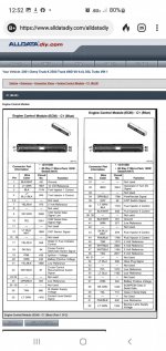

This is what my Alldata shows for this connector. I just looked at my truck side original harness and there are no pins in C1 33 or 35. Maybe these are just for ZF6 trucks? Screenshot_20220122-125236_DuckDuckGo.jpg

Looking over the pinouts you posted in C1 pins 8 (blank on my diagram and in my truck harness), 24 (blank on my diagram and in my truck harness), 37 (shows inj 6 on your pinout and inj 5 on my pinout) and 44 (shows ign voltage 1 on yours and inj 3 on mine). On C2 pin 2 on my diagrams it shows empty and on my truck harness it's also empty. This doesn't make me very comfortable when diagrams don't match on very important items lol. Can anyone verify these? I'm using Alldata that I subscribed to and a Haynes manual and they both match pretty well.

I grabbed a pic of my 2003 GM service manual. It seems to agree more with the Alldata screen shots, in terms of the C1-37 and C1-44 discrepancies the OP pointed out. However, I did note C1-33 shows "crank voltage" in my book vs. Alldata saying no connect.
In the transmission chapter, I looked up the ZF6 related connections to the ECM in my manual - only 4 called out on this schematic page: C2-20/C2-21 VSS speed sensor, C1-35 clutch switch, and C1-58 class 2 serial data.
<edit - added larger size pic>

Thanks for the replies. I may have to look at the pin locations and wire colors of the oem truck side harness to see what matches which diagrams. I wish they had actual "system" diagrams instead of just small sections. I have to bounce around like crazy in the Alldata stuff.
